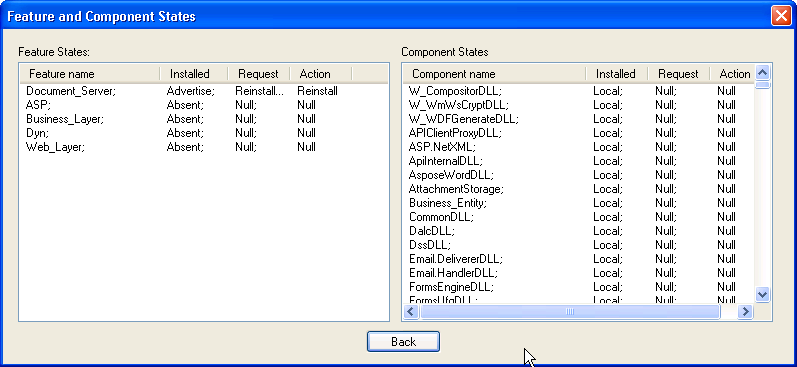

Is anyone else experiencing or can help explain why it appears the recent MS security update 971090 which replaces merge modules in visual studio with updated ATL components appears to be causing the following error on minor upgrade (when upgrading from a setup built prior to the security update to one built after which includes the new ATL MSM):
MSI (s) (FC:D4) [16:38:02:640]: SELMGR: ComponentId '{9B2CAF3C-B0AB-11EC-B01F-C8B3B9A1E18E}' is registered to feature 'Document_Server', but is not present in the Component table. Removal of components from a feature is not supported! MSI (s) (FC:D4) [16:38:02:640]: SELMGR: Removal of a component from a feature is not supported The component ID in this error is for the ATL crt component included to support a 3rd party OEM COM component in our setup. Version of this component under x86 went from 4052 to 4053 (I believe). WiLogUtl.exe msi log analysis shows feature installed state = "Advertise" instead of Local and Request - Action each = "Reinstall". All Component installed state = "Local" and Request - Action each = "Null" (which explained why no files were updated to new version). The package version updates properly in the registry and errors are not presented to the user running setup (only visual confirmation of the dlls did we find this). My question is, considering we didn't change the merge module association within the setup project, why is the version of the merge module being installed causing the SELMGR component removed from error feature? Is this something we should have anticipated, when a newer versioned msm is included in a setup project we have to change the product code and restrict minor upgradeability? Is there more happening here that we can understand to help avoid this in the future as well as to help us explain to our clients why MS security update * causes our installers minor upgrade to fail for the feature with runtime library components affected by their security update? Thanks for taking a look at this, please let me know if you'd like more info or have any questions. I hope to post this at installsite as well in effort to help others who might have similar issues. Cheers, Rob Attached Image (Click thumbnail to expand) ![]() |

Is the component {9B2CAF3C-B0AB-11EC-B01F-C8B3B9A1E18E} included in (the old version of) the ATL.msm? (If it was, could you please send me the old and new .msm because I don't have VS 2005)
Or how did it get into your project? It looks like this component was removed from your setup, which is not allowed in a small or minor update. The other problems are a result of this. -------------------- Stefan Krüger

I looked at the modules and indeed they removed some components. For details see http://msmvps.com/blogs/installsite/archiv...er-updates.aspx
I think the best solution would be to do a Major Upgrade. -------------------- Stefan Krüger
