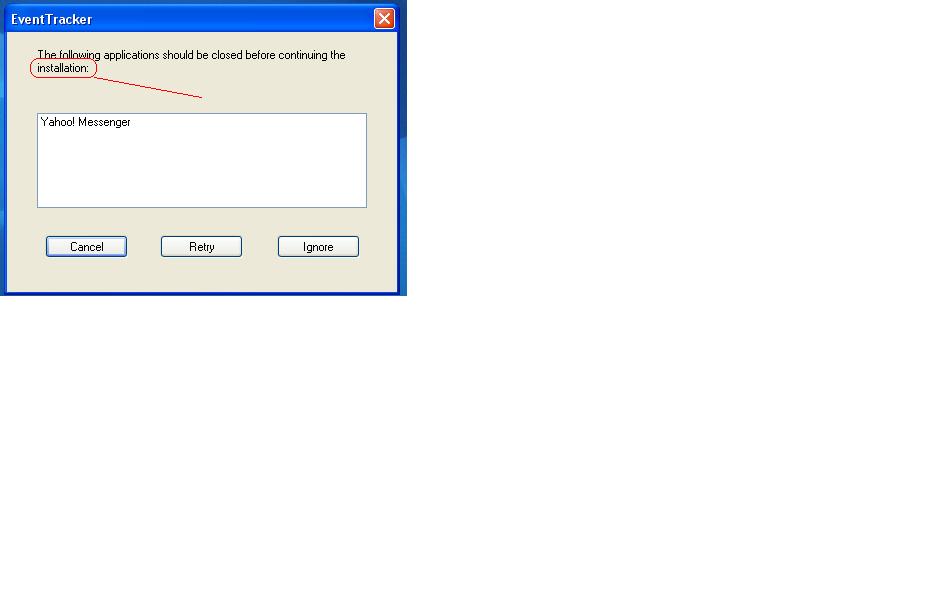

If i try install the setup.exe application it is displaying the dialog with message "The following application should be closed before continuing the installation" ( Attached screen).
i spent more than 8 hrs for R&D about this issue.but i didnt get any solution for this.
please help me if any know's how to solve this issue.
I am not chekcing any yahoo messenger registery.and also services.
My Application components Devlopled In vc++.domain in network based Environment.
Advaced Thanks.

Apparently your install wants to update some files that are currently used by YM.
To solve this, either
- follow the instructions on the screen; or
- detect the files that will be updated. Then figure out if your app also works with an older version of that file, go for the oldest version you can lay your hands on: this reduces the risk for a conflict with any other application. Even better, this also reduces the risk that some other application stops working because of your upgrade.
Posted 01 April 2008 - 13:59
A log file (http://www.msifaq.com/a/1022.htm) might tell you which file is being held in use. Or click Ignore and use the PendMoves tool (http://technet.micro...s/bb897556.aspx) before you reboot.
