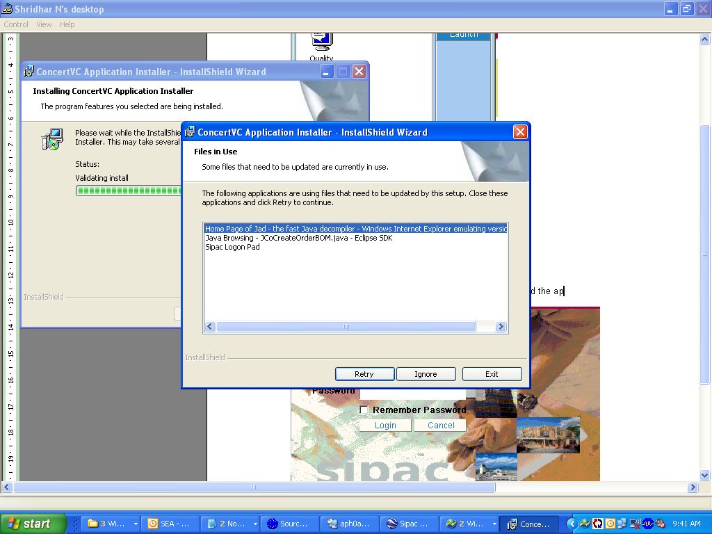

While un-installation of application I got the below message asking me to close the IE. And some times while installation of application asking for close eclipse(JAVA IDE). This message should not ask in installation and uninstallation.
Please suggest me how to resolve this issue.
Find screen shot for your reference.

Apparently, some of your files are held in use by these applications (plug-ins maybe?). To find out which files, check the installer log. Or click ignore on the dialog. This will request a reboot at the end. Before rebooting, use the PendMoves tool from http://technet.micro...s/bb897556.aspx
