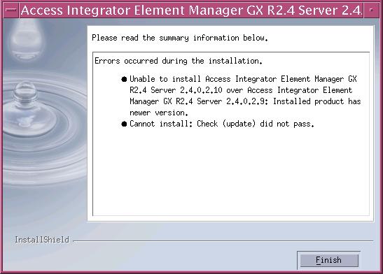

I meet a big problem when I make a software use InstallShield 10.5,
the detail information is in the attachment picture.Why it told me 2.4.2.10 is older then 2.4.2.3? Thanks for help of everybody.

I don't know, maybe it performs a string compare instead of parsing the number fields and performing a numeric compre? In this case 10 < 9 because it starts with a "1"

I found a file named is "ProductResources.properties", and it is under the following folder
C:\Program Files\InstallShield 10.5\Universal Installer\i18n\com\installshield\product\i18n
This file include this line "PureJavaProductServiceImpl.UpdateCheck.installingProductOlder=Unable to install {0} over {1}: Installed product has newer version."
this line is the output information in the picture. How can I find out which project quote this line and it maybe the code about the version compare.Thanks!
