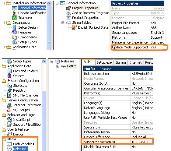

An upgrade updates all features regardless of current installation
