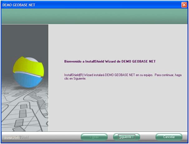

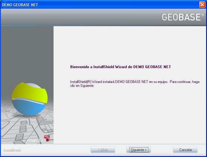

I'm developing a InstallScript MSI project and i have a problem.
I want put images in the left for each dialog.
when begin my project have the follow code that put the first image in the first dialog:
DialogSetInfo(DLG_INFO_ALTIMAGE,SUPPORTDIR ^ "Copy of left_bkgrnd.bmp",TRUE);
Now... in the next dialog, i use the same code for put the new image in the dialog, but not working.
How I do the image change?
I need your help....is very important for my make it.
Thanks

You don't need to call DialogSetInfo for each dialog. Call it once and it should stay in effect for the rest of your setup.

I see. How does it fail? Does it simply fail to replace the image? Or does it display an error message? Did you check the return value from DialogSetInfo?
To make sure it isn't an issue with the other bitmaps: did you try to use your second image in the first call to DialogSetInfo?
Did you try calling
DialogSetInfo(DLG_INFO_ALTIMAGE,SUPPORTDIR ^ "Copy of left_bkgrnd.bmp",FALSE);
before you set the next image with TRUE?
Did you try calling
