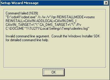

When we are trying to install on one particular W2K3 server using a script we have used on numerous occasions successfully before, we keep getting an error.
I have attached the file to this post. we run the following :
instwiz.exe XXXXX -Rinstwiz.cnf
the configuration file holds the command line parameters etc....
First we get the Windows Installer Box with the version number and the invalid command line parameters, then the error box below. This is strange because it has worked on all other servers the script has been run on.
Invalid Command Line Parameters

Shouldn't the path to the log file be quoted since it includes a space character?
