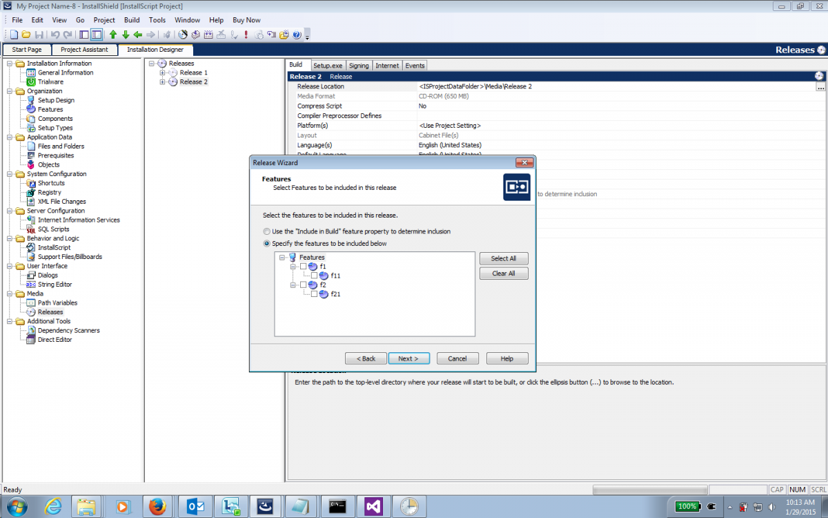

I need a function which I can call during the build of the release through the Automation Interface. I have a script in C# through which I want to call a function of ISWiProject or ISWiFeature( or any such object...) with which I can select the features that I want to include in my this particular Release build.
I need a property something like IncludeInBuild. The problem with IncludeInBuild is that it alters the default behaviour of the Feature. I just want a similar property with which I can Select the features for a paricular new Relaease build only and default behaviour is not altered. Need to do the work in attched screen shot in Release Wizard through Scripting.

Now I understand. So the problem si that the change is stroed in the project file.
I'm not aware of a method to temporarily chage this in an InstallScript project. So the best workaround may be to make a copy of the project file.
