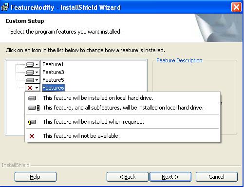

Also is it possible, in the custom setup - Select the program feature to be installed dialog, to show a feature with a cross only, with giving the user the ability to install.
This is rather to show the user that this feature, is not available with this license version.

| Also is it possible, in the custom setup - Select the program feature to be installed dialog, to show a feature with a cross only, with giving the user the ability to install. |
You can make the cross the default, but users would still be able to change the selection, like in your screen shot. It's not possible to have the cross as the only option. Instead you could make the feature invisible, using a feature condition settings its level to 0.
