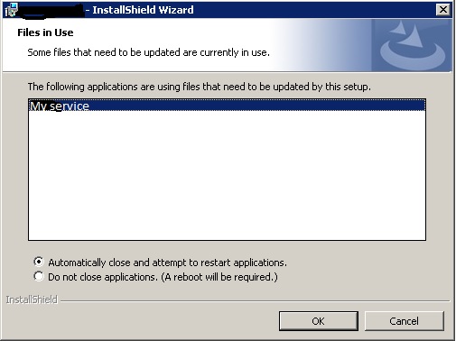

I want my installer (using Installshield 2012) to stop the existing service before copying the files which are being used by the service. So I created a custom action to stop the service.
working directory systemfolder
file name&command line "[SystemFolder]net.exe" stop myservice
Return processing synchronous (ignore exit code)
in-script execution Deferred Execution in System Context
When the installer is at "validating install" stage I kept getting the "file in use" dialog
with two options. I'm not sure why my custom action didn't run successfully.
If I click "Automatically close and attempt to restart the applications" option,
everything works fine but I don't want users to get this dialog.
Anything wrong with my custom action?
Is there anyway to disable (doesn't show) the dialog box and stop the service?
or any other suggestion?
