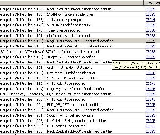

I have been trying it but I have always a few problems.
I use Adminstudio 6 with Editor 10.5, is there problems of compatibility?
Is there any problems with this script ?

Posted 26 August 2005 - 22:06
Try it the other way round:
#include "ifx.h"
#include "NTProfiles.h"
Let me know if that works.
