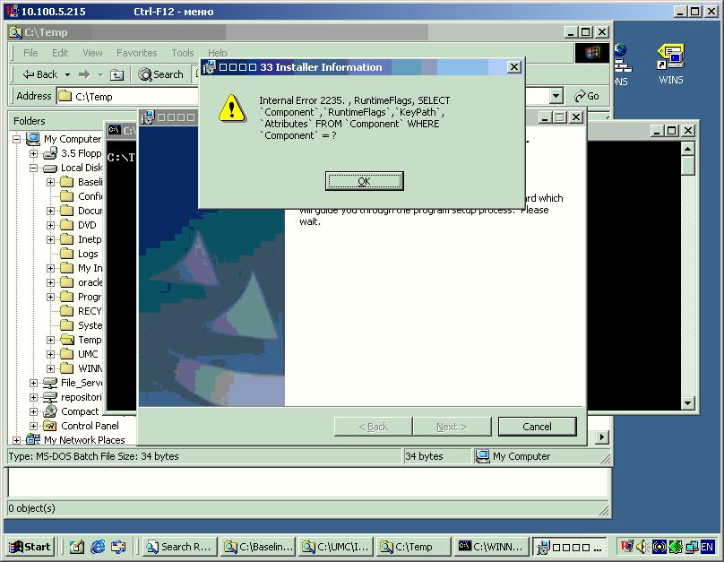

But if I try set Enable Update Service option to “No”, installation routine fails with error in attachment.

DEBUG: Error 2235: Database: . Column 'RuntimeFlags' not present or ambiguous in SQL query: SELECT `Component`,`RuntimeFlags`,`KeyPath`, `Attributes` FROM `Component` WHERE `Component` = ?
DEBUG: Error 2835: The control ErrorIcon was not found on dialog SetupError
Internal error 2835. ErrorIcon, SetupError
DEBUG: Error 2888: Executing the TextStyle view failed
Internal error 2888. TextStyle
Internal error 2235. , RuntimeFlags, SELECT `Component`,`RuntimeFlags`,`KeyPath`, `Attributes` FROM `Component` WHERE `Component`
MSI © (70:98): Product: TEST – Internal error 2235. , RuntimeFlags, SELECT `Component`,`RuntimeFlags`,`KeyPath`, `Attributes` FROM `Component` WHERE `Component` = ?

Did you add any components 8or file) to the projct? I think a setup with no compnents at all can't run. Disabling the update service may have removed the only component (the update service merge module) from the project. Did you get any build warnings?
