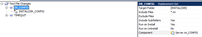

Having an issue here. I configured a Text File Changes replacement set for my Basic MSI Project in InstallShield 2012 Premier, and it doesn't work all the time.

I have configured the Text File replacement set to search for C:\CMEQDB and replace it with [INSTALLDIR]....it doesn't work.

The only way I can have it working (partially) is this:

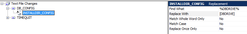

- Changed the C:\ to %DBDRIVE% in the server.ini file (thus giving me %DBDRIVE%CMEQDB\Cie01.db)
- Replacement set searches for %DBDRIVE% in [INSTALLDIR] *.ini and replaces it with [DBDRIVE]
The problem here is that it doesn't seem to adjust to the new [DBDRIVE] value...If I leave [DBDRIVE] as C:\, the replacement is working. If I change it to anything else, it doesn't work.
Could someone help me here ? Kinda lost really....
