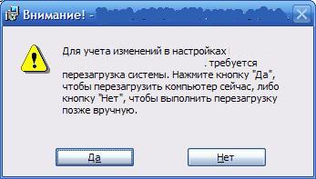

There are window appeared after successful installation (see on the figure).
It is 1703 error -
"you must restart your system" window (1703 error)
nesesser
, Sep 24 2007 10:45
Posted 24 September 2007 - 10:45
| "For the configuration changes made to [ProductName] to take effect you must restart your system. To restart now click Yes, or click No if you plan to manually restart at a later time." |
Q:
Where I can find extra information about the reason of this appears?
May be some properties in log-file, that explain what files are should to be released or something like that? How to find the reason of it?

There could be multiple reasons, but the log should contain information about this. Or, beforew the reboot, use the PendMoves tool from http://www.microsoft.../PendMoves.mspx
