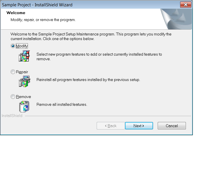

hi all, i want to remove "installshield "watermark on dialogs , which is visible left side down corner on dialog. I found it on custom dialog also. can anybody please sugget me how to remove it.

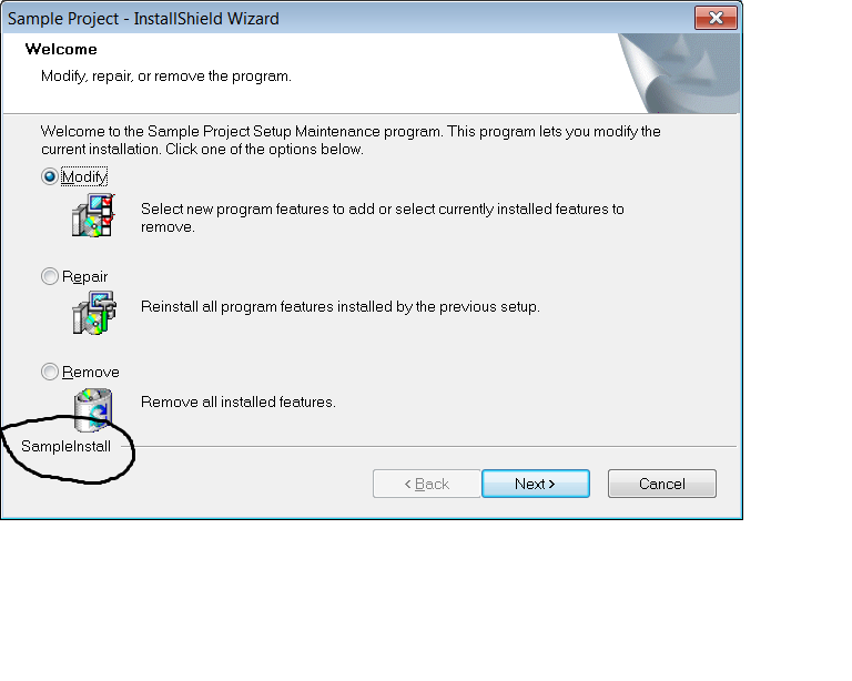

In an Installscript project the UI is handled by the Installshield engine. The _isres_0x0409.dll will help you there but for an MSI base installation the UI is handled by Windows Installer engine. We just need to modify the DIALOG, CONTROL table etc and all happens magically.
The Installshield IDE will not allow modifications to the Watermark in any view.
Follow the following steps:
1) Save the .ism file as xml. The General Information node provides the options.
2)Open the .ism file in Notepad++(not an advertisement). It works for me always.
3)There is a <table name="Control"> node in the .ism file that has all the controls.
4)Each dialog has an entry here. Select the dialog you want. Say, LicenseAgreement. Search for that.
5)There would be multiple entries for LicenseAgreement. Find <row><td>LicenseAgreement</td><td>Branding1</td><td>Text</td><td>...
<row><td>LicenseAgreement</td><td>Branding2</td><td>Text</td><td>...
Make all numerical values in both rows "0". This is very important as this will clear out the original Installshield watermark.
These rows will also have the following strings:
##IDS_INSTALLSHIELD_FORMATTED##
##IDS_INSTALLSHIELD##
6)Create two new rows below them.
<row><td>LicenseAgreement</td><td>NewBranding1</td><td>Text</td><td>...
<row><td>LicenseAgreement</td><td>NewBranding2</td><td>Text</td><td>...
And replace ##IDS_INSTALLSHIELD_FORMATTED## and ##IDS_INSTALLSHIELD## with custom string IDS. For example, create ##IDS_SAMPLE_FORMATTED## and ##IDS_SAMPLE## and insert them in to the rows.
7)Go to ISString table in Direct Editor and define ##IDS_SAMPLE_FORMATTED## and ##IDS_SAMPLE## and provide relevant text.
8) Build your project.
This process was for the LicenseAgreement Dialog. These steps need to be repeated for all dialogs.
Do check the EULA.
