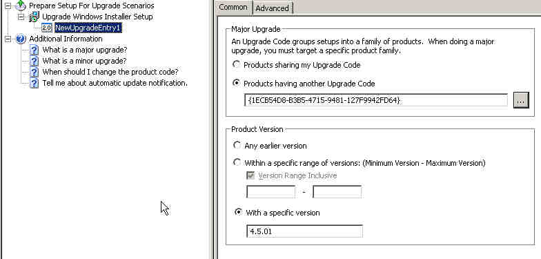

I have msm file (contains my product source).
Then I include the file in msi project.
I tried to add minor upgrade in the project.
But IS raise following error:
ISDEV : error -6423: The project contains a Minor Upgrade item that references the setup
However, the referenced setup can only be upgraded with a Major upgrade.
Please use the Major Upgrade item or the automatic upgrade item.
Then I select Major Upgrade
see attached bitmap
After the project rebuild, the installer can upgrade old version,
but can be the installer modified for detection of old version inslalled?
see attached bitmap

Posted 14 January 2008 - 14:33
You don't need to specify the location of the old msi file. This is only used for update validation, like the build warning you saw. It is only used during the build process, not on your end user machines.
Accoring to the build warning, you made some changes in your setup that make it impossible to build a Sall or Minor update (because several rules apply here, e.g. you cannot remove a component or change a ComponentId GUID, etc.). Therefore a Major Upgrade is required, which means that you must change the ProductCode.
