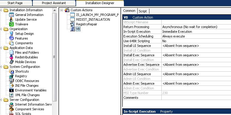

Properties of vbscript custom action:
I had added vbscript custom action in original setup, script stored in custom action itself. I did this work at ok button (using do action), I gave in-script Execution as immediate execution and execution schedule as always execute. I added this as an attachment.
