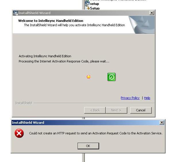

I have a serial number and I'm doing activation by Internet. After filling in the correct serial number installer creates an HttpRequest which is sent to Activation Server. Last days there was an issue with Activation Server, but now is solved. I receive an error saying "Could not create Http request to send an Activation Request Code to the Activation Service". ( I have attached the screenshoot).

I tried with ISDEV, and I got another error: "An unexpected error occurred while sending an Activation Request Code to the Activation Service".
