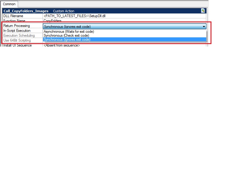

one line above the line where you see that the custom action is defered there is an option called "Return Processing" (attached). when calling a dll there should be 3 options, which one you use?

I've set "Return processing" set as "Synchronous (check exit code) "

Maybe you should try to change it to synchronous (Ignores exit code)

I don't believe you can "capture" the return code from a dll and condition further action based on it. If I understand it correctly, a return code of anything other than zero will cause the MSI to fail and rollback if you use "Synchronous (check exit code) ".
(And since it is a deferred action, you won't be able to set a property to use in conditions after the custom action.)
What you may want to try is to have your dll itself display the alert, then return 0 if you want the msi to continue processing, and an error code if you want it to stop and roll back (or just set it to ignore the exit code and it will always continue).
