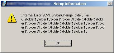

I faced with a such feature of Windows Installer - when I enter a long path to INSTALLDIR property appears 2893 Error (in attached file).
In log-file appears:
2893 Error: too long path specifyed
nesesser
, Jan 30 2007 12:49
Posted 30 January 2007 - 12:49
| DEBUG: Error 2893: The control Tail on dialog InstallChangeFolder can accept property values that are at most 240 characters long. The value C:\folder1\folder1\folder1\folder1\folder1\folder1\folder1\folder1\folder1\folder1\ folder1\folder1\folder1\folder1\folder1\folder1\folder1\folder1\folder1\folder1\ folder1\folder1\folder1\folder1\folder1\folder1\folder1\folder1\folder1\folder1\ folder1\folder1\folder1\folder1\folder1\folder1\folder1\folder1\folder1\folder1\ exceeds this limit, and has been truncated. |
240 characters - whence this number?
Q:
Is it limit of Windows Installer or it is a bug?
What the maximum path length which I can specify?

Posted 31 January 2007 - 10:28
As far as I know "NTFS on Windows 2003 Server supports a maximum length of 260" for file (or folder) names. But there are other thing.
Here we have a limitation of whole path. So, it's impossible to specify path that exceeds 240 length (or 260 - a little difference).

Posted 01 February 2007 - 07:10
Thnks a lot to your support, friends.
And I'm apologizing - there are really Windows limitation.
I tried to create that Folder1-path. But error message appeared in some moment.
I counted path length - it was 242 chars. And it was forbidden to create anything in this folder.
So, I conclude that it's a Windows limit, because the limit of edit control are 2147483646 characters (according to Edit Control topic).
