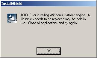

Hello Everybody,
I am facing one problem with installation on windows 2003 server SP1. I am using Installshield 11 Professional. When I double click on the setup exe and extraction of msi goes on, before starting the installation wizard, I am getting following error msg…
“1603: Error installing windows installer engine. A file which needs to be replaced may be held in use. Close all applications and try again.”
Can anybody explain me, why this is happening? And any solution for this

Posted 17 May 2007 - 15:50
Which version of the MSI engine are you trying to install?

Posted 18 May 2007 - 18:34
If you don't install the engine, your setup won't work on Windows versions that don't include the engine. Today this is quite rare. For information about which Windows version includes which version of the MSI runtime see http://www.msifaq.com/a/1001.htm
There might be a problem in IS 11 that it's trying to update the MSI runtime of W2K3 SP1.
Posted 31 May 2007 - 17:09
If it is a problem in IS 11 (which I'm not sure it is) then you could either update to IS 2008, or create a custom prerequisite to install the msi engine.
