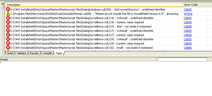

Im new to installshield and i have very little idea about working with installscript. I have an installscript MSI project and i get the following errors when i build the project.
1.)There were errors compiling installscript ( ERROR CODE-4370)
2.)An error occured streaming ISSetup.dll support file D:\TAW Installshield\WorkSpace\Master\Master\Script Files\Setup.inx(ERROR CODE - 7132)
Could the cause of these errors be some missing files or is it due the scripts?? i have no idea how to work with scripts...please help me out.

1) I believe the function is called GetCurrentDir, not GetCurrentDirectory. Check your code, note the syntax coloring.
2) This is a consequence of 1). setup.inx is the compiled script. If the script couldn't be compiled, there's no setp.inx, and therefore it can't be built into the package.

There was some error in the script itself, but that got sorted out. And the function was GetCurrentDirectory.... you were right, the setup.inx wasn't built. Thank you
