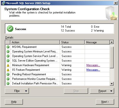

I have a question - did you saw the SQL server 2005 setup programm?
I'm interested in User Interface used there - in ListBoxes. There are used unsupported controls on some dialogs (HyperLinks - view in pic)
This controls (HyperLinks) are not supported by Windows Installer (at least in 3.1ver in which I made a screenshots).
And it is not a bootstrapper - I checked it through Process Explorer.
It seems that these controls realised in MSI package directly (probably through cunning Custom Actions).
Q:
How it could be? =) How to do it in my installation?
SQL server 2005 installation: unsupported controls

I'm pretty sure this is an external UI. Which means that have to use some EXE launcher because you can't use an external UI with just an .msi file.
Posted 19 April 2007 - 05:26
What does it mean - external UI? How can I make UI like this?
Probably you would say, that is need to use some DLL creating UI. But how can I interrupt UI from Sequence to show needed external UI?
Posted 19 April 2007 - 18:13
You can find documentation in the Windows Installer SDK in topic MsiSetExternalUI
