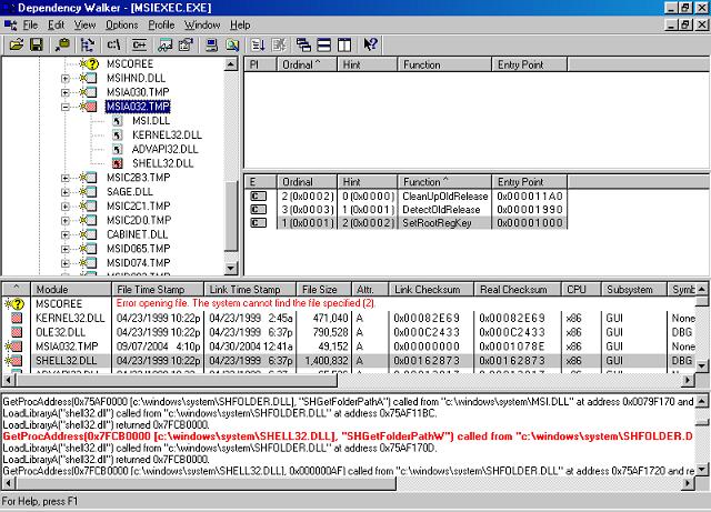

I received the same error 1723 on Win98 and not on other OSes.
I traced the problem to a DLL, included in the Binary table, which, when extracted on Win98, had a missing dependency on Shell32.dll's SHGetFolderPathA export. This DLL should rather have called SHFolder.dll's SHGetFolderPathA function, because that is universally present on all OSes.
My problem is now to find out whether this is an Installshield DLL or not and where to get a version (or total install) that is compatible with Win98. I don't have the DLL's name, but it exports the following 3 functions, as indicated in the attached bitmap: SetRootRegKey, DetectOldRelease and CleanUpOldRelease.

Posted 07 September 2004 - 15:55
You could extract the DLL from Binary table to a file, and then look at it's version info.
Posted 08 September 2004 - 11:56
Thanks for the reply.
I did extract the DLL, but it doesn't have any version info.
Glytzhkof, the .tmp extension and filename is given by the Windows Installer Engine when it extracts the files from the Binary table to the temp folder.
I have in the mean time figured out that the DLL is probably the software vendor's DLL and not Installshield's, because the custom actions that calls the DLL have conditions that were clearly added by the software vendor.
I'll now try to recreate this install without the DLL, while waiting for a possible new install package from the software vendor.
