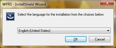

I have requirement to cahgne the predefind language from English(standard) to english. but i am not getting how to change the default languages string.
If any one have idea on this, please help me.
Tahnks,
Yazhisai
language seelction

E:G for changing the language string value from English (united state ) to English(US),
First go to <installpath>\Support\0x0409.ini file, open the file and at the end of file you can find the list of languages there you change the english(US) and save. supose if the installshield is installed in C: drive , pleasemake sure that you have enough admin rights to override the file.
