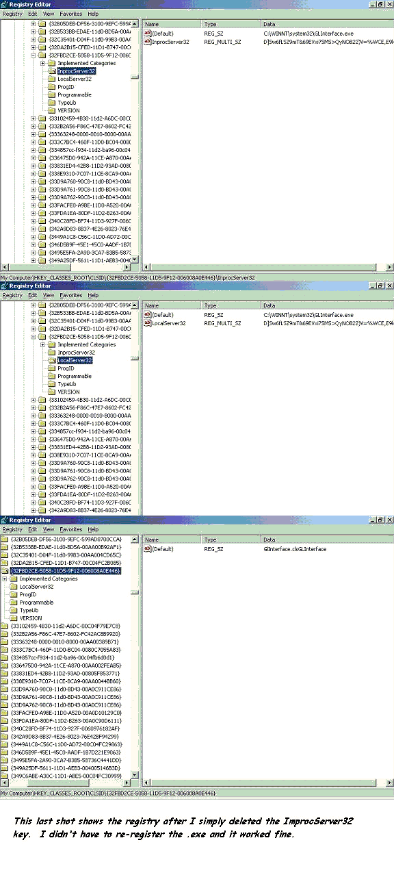

I've attached some screen shots of what is happening. When this functioned properly we were only getting HKLM\Software\Classes\CLSID\{ID Code###}\LocalServer32 registry entry. Now we are getting the ImprocServer32 entry as well, which seems to be tripping this up. You'll see from the shots what we are getting now. I simply delete the ImprocServer32 key and the application works fine without re-registering.

Windows installer guidelines say that you should really exctract the COM information from these components rather than self-register them. You might try to enable the "COM Extract at build" for the component and remove the self-registration custom action. There is a good chance this will work correctly. The added bonus is that you are following the windows installer guidelines (adds a number of benefits).
Windows installer cannot self-register an EXE file, but it can self-register a DLL. However, there are some special Installshield tables called something like ISSelfRegister. This is a table where you can add components that need to be registered and specify a registration order. It is also capable of registering an EXE and defaults to a /RegServer command line. This is the second option for you I believe after trying the COM Extract.
Finally, it is possible that since you have upgraded the project from an earlier version that Installshield has really enabled the COM extract and is now doing both this and self-registration. I would have a look at the comonents in question to see what they are really doing. And I would also have a look at the different tables in the Direct Editor.
