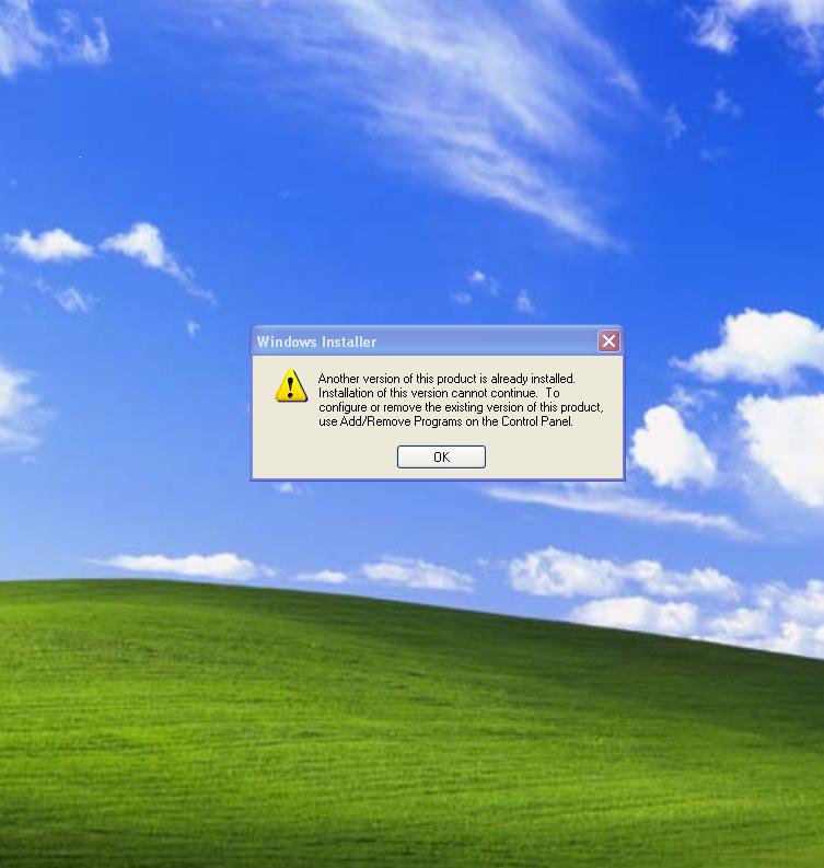

I installed the lower version of the application with .exe and tried to upgrade it via .msi pf higher version.Then the error shown is attached below.
I was using below command line parametrs
msiexec.exe /i "xyz.msi" REINSTALLMODE=vomus REINSTALL=ALL
Thanks & Regards
Smitha

Are you sure the msiexec was executed with REINSTALLMODE=vomus, especially 'v', if that is missing you will get the error attached.
