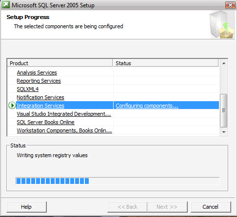

I am planning to develop a fairly large nested install. I would like it to behave in a similar way. Especially the dialog as attached where they link to the verbose logs. Does any one have any idea how they did it. I looked through their dialogs using the IDE but could not find the dialog. I would appreciate any help or comments especially one of the SQL install developers.

I guess the SQL 2005 install uses an external EXE as a shell for the msi based installs.
Posted 19 July 2006 - 10:04
Yes, I think it's in the executable. They may be using it as external UI handler. I'm pretty sure that this is not dialog that is stored in the msi file.
