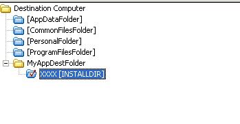

I defined my destination folder as a "registry dependent" folder:
MyAppDestFolder\XXXX
[MYAPPDESTFOLDER] should get the value read in the registry of another software, and it should be set before the "Destination Folder" dialog.

Hence I solved my issue with the following:
1. The CA must be an immediate action, just after CostFinalize (Install UI sequence)
2. I must use MsiSetTargetPath instead of MsiSetProperty in my script to set the value of "MYAPPDESTFOLDER" otherwise the INSTALLDIR will not be changed.
For (2), do you have any idea why it didn't work with MsiSetProperty?

This is probably because you are dealing with a directory table entry. From the SDK it looks like MsiSetTargetPath will cascade changes done to related directory table entries. A word of caution in there too:

This is exactly what I observe in the log files. With MsiSetTargetPath, the change of the property is propagated to INSTALLDIR, not with MsiSetProperty.
MsiSetProperty(hMSI, "MYAPPDESTFOLDER", szDestPath);
InstallShield: Invoking script function ExFn_SetDestinationPath
MSI © (E4!04) [16:40:22:312]: PROPERTY CHANGE: Modifying MYAPPDESTFOLDER property. Its current value is 'C:\MyAppDestFolder\'. Its new value: 'C:\ThdParty\'.
MsiSetTargetPath(hMSI, "MYAPPDESTFOLDER", szDestPath);
MSI © (1C!F8) [16:46:19:638]: PROPERTY CHANGE: Modifying MYAPPDESTFOLDER property. Its current value is 'C:\MyAppDestFolder\'. Its new value: 'C:\ThdParty\'.
MSI © (1C!F8) [16:46:19:638]: PROPERTY CHANGE: Modifying NEW_DIRECTORY1 property. Its current value is 'C:\MyAppDestFolder\XXXX\'. Its new value: 'C:\ThdParty\XXXX\'.
MSI © (1C!F8) [16:46:19:638]: PROPERTY CHANGE: Modifying INSTALLDIR property. Its current value is 'C:\MyAppDestFolder\XXXX\'. Its new value: 'C:\ThdParty\XXXX\'.
