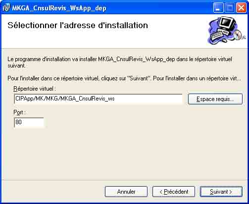

Posted 20 October 2004 - 19:21
In that image, what I want to get is the value of the "Répertoire Virtuel" (Virtual Directory) field. The value is there by default the second the msi is clicked.
I can find it by opening the file in hexadecimal, but it is never at the same place, so I can't use a fixed adress to find it, and since there are other directories as well in the file, I can't tell them apart.
Is there a way to get that value with the API?

Thank you, I finally found it!
It's in the table "CustomAction".
There will be a row with the action "WEBCA_TARGETVDIR" or "DIRCA_TARGETDIR" depending if it is a network/web installation or a local installation.
So I can do
"SELECT Target FROM CustomAction WHERE Action = 'WEBCA_TARGETVDIR'"
or
"SELECT Target FROM CustomAction WHERE Action = 'DIRCA_TARGETDIR'"
to get the info I was looking for.
