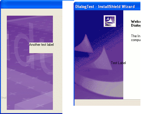

Posted 19 January 2006 - 14:36
I've tried putting a text control on top of an image on one of the standard dialogs and it look OK. I've also tried putting a text control on top of an image on a custom dialog and it doesn't appear to be transparent.
Any ideas? Is there something I need to do when I create the dialog to get it to work? Here's the dialog code:

Posted 19 January 2006 - 15:05

Any idea on why the label transparency works on the standard dialog but not on the custom dialog?

| Any idea on why the label transparency works on the standard dialog but not on the custom dialog? |
No, maybe some setting is different (might even be a setting that's not visible in dialog editor. Did you create your custom dialog as copy of a predefined dialog?

No - the custom dialog was created 'from scratch' and not from a standard dialog.
