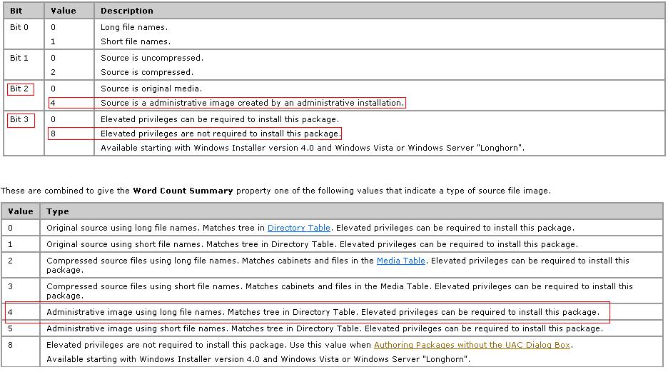

* By default when we set "Require Administrative Privilege = No" in InstallShield -> the Word Count Summary is set to Bit 3 (Value 8) - see picture
* During the administrative image creation , the Word Count Summary will change to Bit 2 (Value 4). This change makes the administrative rights to be required.

Which operating system and MSI version is used to create the admin image? Note that older versions of MSI don't know about bit 3.
Does the value flip to 4 (instead of 12) on XP, too? (It makes no difference on XP because there's no UAC, but anyway)

Hi Stefan, we have tested to create the image with Windows Installer 4.0 and 4.5 on Vista but we still get the same result, the Word Count Summary bit is still changed from Bit 3 (Value 8) to Bit 2 (Value 4).
