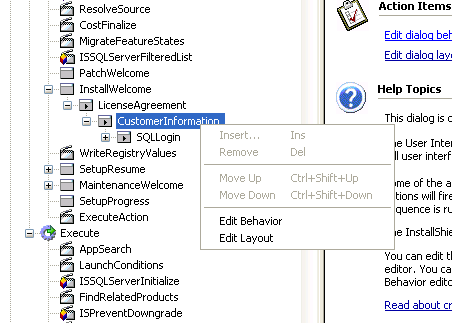

this time i dont know - if i want to use the customer information DIALOG and just edit the form for my usage , and i want it to be after the sql login, the opption to move down is disabled (see attached file).??

Posted 01 March 2011 - 16:17
| opption to move down is disabled (see attached file) |
That's probably because there's a branch or conditions that are too complicated for the simple "move up/down" option.
Go to the SQLLogin dialog, edit Behaviour, select the "Next" button, change the target of the NewDialog event to be your text box dialog.
