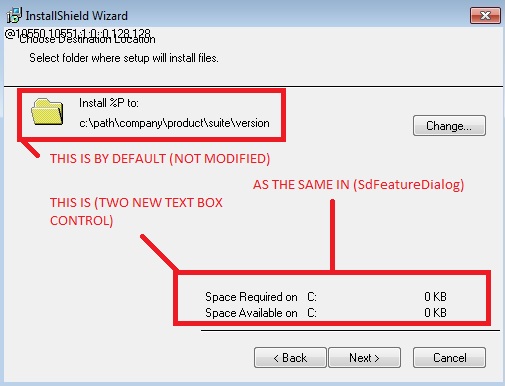

Additionally I use in dialog "SdAskDestPath2" with two text box control. One of those i want to set the size of total feature, and the other, I want to put in the space avaible on disk.
If i put this part of my code in section "Dlg_AskDestPath2" then when I test the installation I see 0 kb in one of the text box, so did not set well.

#define TXT3 1306 if (nSetupType = CUSTOM) then FeatureGetTotalCost (MEDIA, szDir, nTotalReqSize); NumToStr (szText, nTotalReqSize); CtrlSetText (SD_DLG_ASKDESTPATH2, TXT3, szText); nResult = SdAskDestPath2( "", "", szDir ); TARGETDIR = szDir; endif; |
however when i test the installation with debugger i see the correct size of features:
szText = 45678 KB
so whats the problem???

Hi taco...
Sorry i didn't modify in "SdAskDestPath2" the two text box controls. I added two more text box control as the same in "SdFeatureDialog".
If i added more controls in a "default dialog" will be consider as "Custom Dialog" ???

I have a problem about Space Avaliable in hard disk drive, so i can see the correct size of my drive C:\ but if i select another folder in "SelectDir" the other text box control not changes and always i see the size of my first unit drive.
I have installed another drive, this drive is an USB HDD and his capacity its 500 GB. Perhaps i forget to put some code in a (case of SD_PBUT_CHANGEDIR) ???

Based on your reports and in looking at the code, I do see an explanation behind the behavior you're seeing.
Specifically, you only populate the available disk space (TXT5) as part of the dialog initialziation when you also need to do that as part of a directory change in case it resides on another drive.
So your theory was correct and hope it helps.
