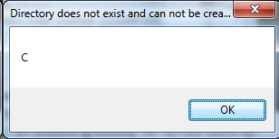

As far as the original problem, I feel more and more that the pop-up is dependent on the environment. On 4 pcs this was executed on, only 2 of them showed this pop-up.
