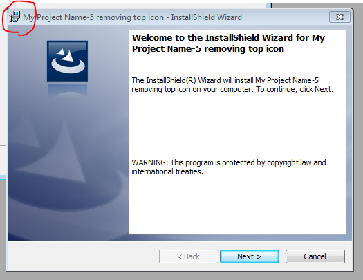

Best Answer Stefan Krueger , 09 May 2014 - 16:35
This icon is coming from the Windows Installer service itself, so it's part of the OS and cannot be changed, unless you build an external user interface or a Suite/Advanced UI project to wrap around your installer.
